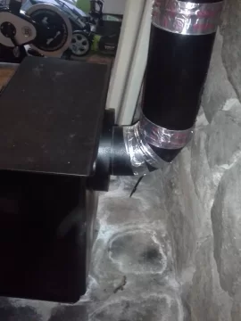

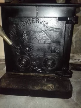

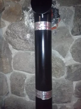

It looks like its an All Nighter from 1978. The guys who came to the house didn't do any painting. They came to check why it was smoking and that's what they told us (although I am not sure how experienced they were; they looked like they were in their early twenties; sorry for discrimination). Here are some pics.
How do I check what it was painted with? If it is normal to smoke, when will that stop? We haven;t used the stove since that last time since we are concerned about the fumes.

If this is conventional lacquer spray paint then lacquer thinner will take it right off - before it is baked. Heat will change it chemically and I'm not sure removal will be as easy. If this is stove brite, acetone is the solvent. Maybe do a test on the back side to see what removes the paint best?
And get rid of the metal tape, that does not belong on stove connector pipe. It is not rated for the high temps the pipe will see. Get if off before it too becomes a baked-on mess.
PS: The stove appears to be missing its legs, but maybe that is just the angle of the camera.

It has legs, I just didnt take good pictures. The metal tape was actually put on by the two guys who came to look at the stove. It does appear that they dont know what they were doing, I guess. I will try acetone and lacquer thinner to see if that's going to work. If normal stove paint was used, how many times is it normal for it to smoke?
Please don't tell me you paid these guys for the tape job.
You definitely have more problems with your installation than simply the wrong paint! With all that tape on the pipe and elbows it's pretty clear the stove must have been leaking smoke or creosote why would someone attempt to seal the joints in that way? I would get things checked out by a real stove guy if you don't have the knowledge yourself. It is apparent the guys you had check it aren't all that knowledgeable if they did not talk to you about removing the tape on your pipe and checking out why it was put on there in the first place.

Being an older stove, what about a angle grinder with a wire wheel? Might be able to take all the paint off, and then you can really inspect the stove
