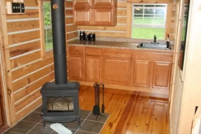

We had the same problem last year. Our choice was the Jotul Nordic. Nice little stove, great view of the fire.
  • [Hearth.com] Wood Stoves
