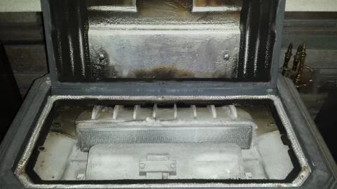

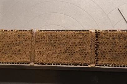

Did any one figure out their issues with the cat clogging and needing cleaning every few weeks?
It sounds like some people have this issue and other's don't.
If anyone figured out how to reduce the ash buildup on the cat it would be great.
This year I managed to go 1+ months before cleaning the cat, which is great for us. Last year it was every two/three weeks.
I brush the screen every once in a while using my chimney brush.
My wood is mostly ash with some beech and red oak thrown in, all seasoned.
rear venting into an interior, 1.5 story chimney w/ insulated liner

I clean my cat about once each month. Do you still have the screen installed in the firebox that is above the front glass? I know that some people have removed that and I wonder if that is contributing to the cat getting clogged. Overall, the cat is quite easy to clean. It probably takes me less than 5 minutes. I blow it out with a can of air (what is used on computers) and brush it off. At the end of the season I do the 'deep clean' prescribed by Woodstock (vinegar bath).
My cat has clogged since I first got the stove. Removed the screen last April. The cat is, if anything, less of a problem. Certainly not more of one.
I'm convinced that a strong draft and no ashpan are the primary contributing factors to the clogging of the cat. I have ordered an ICC damper section, which should arrive this week. I'm hoping it will slow draft enough to keep more heat in the stove and the pipe temp down, and also alleviate the cat clogging. I have an ashpan on order, which Woodstock will install when they service my stove....next summer.

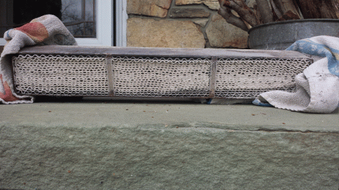

I don't know what anybody is talking about - my cat never clogs look how clean it is.
[Hearth.com] Woodstock Progress - cat & screen cleaning
Truthfully, I think the cat stopped lighting off and that led to a death spiral-clog.

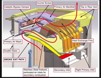

Pic no. 2 has me curious of how the bypass works on this stove. Does the smoke pass by the cat when it is bypassed?
Here is a picture of the Progress internals. The red arrow shows the path when the cat is engaged. It looks to me like the bypass door should be shown in the down position to provide the red arrow path, but it's shown in the up position.

BK owners: With a tall stack and top vented, this stove can develop a very strong draft. With the ashpan in place, ashes drop into the pan and are out of the firebox. No ashpan, some ashes are pulled up by the draft into the emissions path. The route to the cat is tortuous(no, no air goes through the cat when the cat is not engaged), so much ash is deposited before it reaches the cat. However, enough reaches the cat to surface clog it over the course of a month or so. Simple solution seems to be to add the optional ashpan if you have a tall stack/strong draft/top vent.

It looks like the back side of the cat (toward the front of the stove) is susceptible to fly ash from running the stove in the bypass position?
I wasn't asking if air went "through" the cat when bypassed. Just saying that it looks like ash build up while running the stove bypassed could be sucked into the cat when the bypass is shut since it appears the cat is outby the bypass door in the smoke path.
I am probably wrong about that though since it's hard to tell exactly what's going on from the pic witch is why I asked.
I appreciate fire-mans post but I honesly still can't see it good enough to tell exactly what's going on.

Rideau, this does seem to be an issue unique to Woodstock, though. In my Jotuls, the cat is in updraft at rear of firebox, and the cross-section of the inlet chamber is about 4x the cross section of the cat element. This is a good design, as air velocity drops at this point, and any ash simply falls to the chamber floor, rather than being drawn up vertically into the cat. I leave my stoves with a constant 2" - 3" ash in the floor, and will find 1/4" - 1/2" fine ash in the floor of the cat chamber after 4 cords, but never any ash at all in the cat. Monthly cat removal and dusting is just insane! I don't want to deal with that until the end of the season.

Tarzan,, Actually, the cat clogs on the side toward the back of the stove, where the intake air is when the cat is engaged. If you lift the top and look at the cat in situ you would not know it is clogged. It is surface clogging only, easy to remove.
