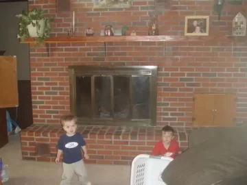

I'm debating between installing an insert vs. a woodstove where I have an existing large fireplace. The fireplace opening is 45"W x 29"H x 24"D. I'm heating 3000 sq ft.
If I go with a stove, do all of the clearances apply? For example, if there is supposed to be 24" of clearance behind a stove, do I need that when putting the stove in a masonry fireplace rather than in front of a wall? Same question for the sides.
I have a raised hearth so the stove can't sit far outside of the fireplace.
Picture of existing fireplace attached.

Nice set up. You may want to keep an insert in mind in the back of your head. With freestanding you run into more clearance issues with the mantle. Take a look at some stoves first, then see whether or not they will fit into your fireplace with the mantle clearances.
The clearances are to combustible surfaces. There should be no combustible surfaces in the fireplace, so you are ok. However, the mantle would be an issue unless shielded. The stove would heat better being a bit outside of the fireplace unless it has it's own blower. If necessary, the hearth can be extended, flush, at floor level to achieve proper coverage.
That said, a good insert may work just as well and might do the job fine. The clearance to the mantle will still be an issue unless the insert is flush faced.

The Pacific Energy Summet is an insert that is rated for 3,000 sq ft. Take the rating for what it is worth of course, but it is one of the larger inserts made. It does not fit flush however.
The Quadrafire 5100I is another large insert that is rated for 3,500 sq ft. Also not flush.
It would appear either would fit.

One option to look at for a flush unit is the Avalon Perfect Fit, also sold as the Lopi Declaration with a different trim.
(broken link removed)
(broken link removed to http://www.lopistoves.com/product_guide/detail.aspx?id=219)
Heating the whole house may not work out, that's more a function of the house's insulation, stove location and house layout. But this unit will give a good long fire and will put a serious dent in the fuel bill.
