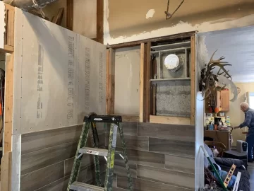

Finishing up reconstruction of a fireplace backdrop at my camp, the situation neverr bothered my father but I felt the former situation was more than a bit of a fire hazard. Prior platform was simply tile on drywall and back corners of a small Timberline woodstove were only 6" from the wall.
Tore everything out to studs and installed 1/2" hardibacker cement board to walls and replaced tile, stove platform extended significantly to provide much more clearance. Entire wall is now tiled and non combustable but i am looking for input on whether I handled the chimney nipple adequately.

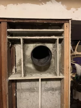

Didn't take pics of the tear out but found that the only shield at the cast iron chimney nipple within the wall was some kind of 1950s asbestos like mache that was packed over the top of the nipple with wood studs nearby. Was masked up but tried to quit breathing as the stuff fell apart.
Elected to shield the nipple with a fabricated box of hardibacker board mortared into place.
Is there any need or merit to packing the nipple cavity with ceramic fiber loose chimney pipe insulation prior to hooking up the stovepipe?
Studs near chimney nipple are 2x4s for reference.
