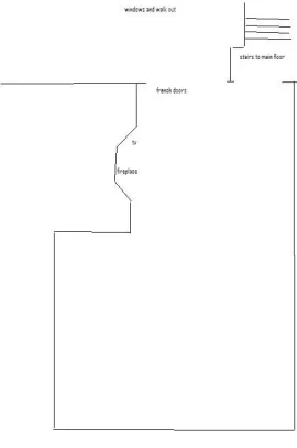

It might work fine, but we need to know a bit more about the setup. How would the heat get upstairs? If the passage is easy to upstairs via an open stairwell, that can relieve a lot of the heat from the room. A floor plan or simple diagram would help as well as pics of the location for the stove or insert. Also, how well insulated is the basement? And one last concern, why is the fireplace where the stove is going not usable?

thank you so much for all your advice! Really appreciated. I have included a sketch of the basement. The space in front of the fireplace is about 10 ft. The house is 50 years old - the basement is insulated, but I don't know how well (we only moved in a few months ago)
The problem with the fireplace is that it "smokes", the chimney is possibly not wide enough for a fireplace. Since we would have to install a liner for a wood stove, this should resolve that problem, so we've been told, and get more efficient heat

Does smoke roll out of that fireplace even after it is up to speed or is it just when you are getting a fire going? Because you are all the way in the basement, you have a longer run of flu with more cold air pressing down into the firebox and it can take more time to heat up and get drafting well. It looks like an interior chimney that runs up through the middle of the house from your floorplan pic, which should minimize the issue. You may sill get a little smoke rol out from the stove on startup, but with the proper liner it should be minimal and once everything is hot you shouldn't see it continue.

I can't tell from your sketch whether the stairway is open. That also makes a difference. We have a ceiling fan at the
top of the stairs in the vaulted living room which draws the heat up.
