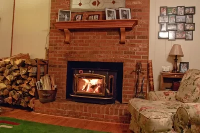

The Buck 91 actually comes with legs and is designed to be installed either way. I have it as an insert but it still sits out pretty good on the hearth. I left the surround off because I liked the "wood stove" look better than the insert look. Also think I get more heat from it this way. [Hearth.com] Would a wood insert installed as a stand alone be the same as a wood stove?
