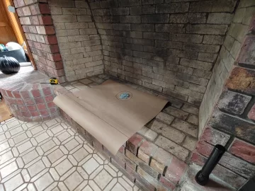

We are considering buying a used Osburn 2400 insert for the fireplace in our living room, but I'm concerned about how it will look in our particular fireplace that has a raised hearth, plus a slightly raised brick lip in front of the hearth. I'm probably not explaining that very well, so I've attached a couple pictures that hopefully show what I'm talking about.
Question 1: I created a paper template that is the exact footprint of the insert and drew a line across the front showing where the insert will hang out over the front bricks if the insert is pushed nearly all the way back into the firebox. The overhang is about 4-3/4 inches. That also happens to be the front-to-back depth of the blower on the front of the Osburn 2400, so I believe the blower would be the only part extending past the front bricks. Would this look bad having it hang past the bricks in the front?
Question 2: The bricks in the front are about 1 inch higher than the hearth behind them. Would I have to add some sort of shims under the insert to account for this? Possibly something like Durarock? The Osburn manual mentions leveling feet on the rear of the insert, but nothing on the front.
Maybe a flush insert would look better in our case, but I found this insert for sale locally and would like to make it work if possible. What do yall think?

Yes, this looks like a flush install would be best. The minimum extension with the 2400 is 5.25", and that requires 19.5" depth @ 22" high.

Thanks, begreen. I just checked to be sure, and at minimum extension there would be a little over an inch left between the top rear corner of the insert and the fireplace bricks. Further down from the top corner there is more clearance because of how the fireplace rear wall starts angling frontward about halfway up. I couldn't find anything specifically from Osburn on required clearance back there, but I read at least one person here mention it's generally acceptable to push it all the way back touching the bricks if needed. So just on having enough room, I should be OK, right?
Just to make sure I'm understanding correctly, the 5.25" would be measured out from the brick surround to the very front edge of the insert, right? If so, that means that the front edge of the insert would hang over the bottom bricks by about 1.75", taking into account the thickness of the bottom row of bricks. Would that look terrible, or just slightly unusual? It doesn't seem too bad to me but I could be wrong about that.
Another thought I had was that I could add another row or two of bricks in front of the existing ones to bring the "hearth" out further so that the insert wouldn't hang over any. I'd honestly prefer to not have to do that, but we do have quite a few leftover bricks from when this house was built 30 years ago, so I could go that route if needed.
Any other thoughts on how that insert would look extending past the bricks by a couple inches, or adding another row of bricks so that it wouldn't hang over?
I'm trying to get everything together for the install (liner, adapter, etc), but I don't want to order anything until I decide for sure on the Osburn.
