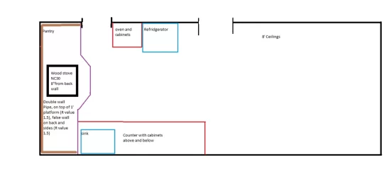

I plan on removing the pantry on the right and the cabinets on the left to allow me to build a raised hearth and to set false(?) tiled walls behind and to the sides of where the stove would be. I want to cut out a section of the wall on the left (2'x1') for a fire damper to help circulate air into the adjoining room. there will also be a cutout on the bottom with fire damper to bring cooler air back in.

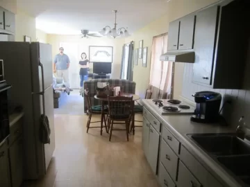

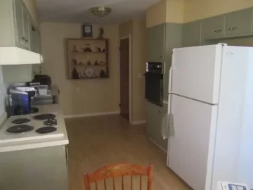

Here is a pic of the adjoining room. I would also like to make a cutout with fire damper behind the fridge so the cold air from this part of the house can circulate under the raised hearth and behind the false walls. Both cutouts would have fire dampers.
[Hearth.com] Would this setup be adequate/safe??
Everything will be checked by the town's fire marshall and buildings dept and work will be done with appropriate permits, I just wanted to ask if this was do-able before i submitted my plans. the kitchen where the woodstove would go has two doorways (no doors) leading to other parts of the house.

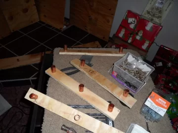

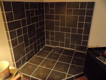

I forgot where i got these pics (a while back) for ideas on how to make the walls behind and to the sides of the stove. the hearth i plan on building would be a foot or more tall. does this all sound ok??
[Hearth.com] Would this setup be adequate/safe?? [Hearth.com] Would this setup be adequate/safe??

Is the adjoining room in a different residence? 2 kitchens back to back?
My first thought was that the stove in the kitchen will feel very close to the "activity" of a kitchen, and maybe heat you out of that room, mostly because the room looks narrow and there are active places on both sides - fridge, dishwasher, cabinets, sink, electric range, wall oven, etc. May not be an issue but I'll throw it out there. :)
Hello mfglickman, it is funny you mention that because we are having that same discussion (two residences) with the town at the moment. when we bought the house it was listed as a mother-daughter but the original owners put up a wall to divide the two spaces. we intend to take that wall down (it was put up without a permit) as we have no intentions of using that side of the house as an "aptartment". the town wanted us to get rid one of the following so that it wouldn't be considered two separate residences; refridgerator, stove, kitchen sink or full bath. we (my wife) like having the second full kitchen and will not be getting rid of the full bath so the town agreed to let us keep it as is as long as we sign an affidavit stating that we will not rent that area out as an apt (never was our intention).
back to topic, lol... the room is 9'x30' and after the 30' mark opens up to 13' for another 10-15 feet. there aren't any doors closing off that room and I was hoping the openings near where the stove would be could provide enough circulation to keep this room somewhat comfortable while at the same time provide heat to the other room. It would definitely be easier to setup the stove in the bigger room but the wife never even entertained that idea o_O .

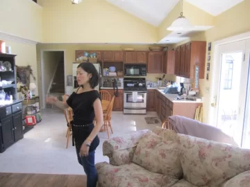

here is a pic of the room from where the stove would be. BTW, that side of the house doesn't get too much use ATM. my wife uses the kitchen when cooking big meals for holidays and family get togethers and when she makes soap.

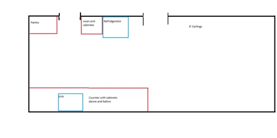

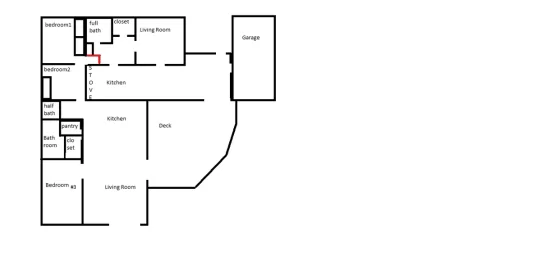

this is a pic (not to scale) of the layout of the entire house
above the left side of the bottom half (above bedroom #3, bathroom and closet) there is a loft with vaulted ceilings for the loft kitchen and living room...the most central part of the house is in the kitchen we barely use, where i want to put the stove. I believe the red walls are the ones without permit.
Its going to get hot as hell in that small area in the kitchen, and the heat may or may not move around to other parts of the house. That depends on how open the area is. Id be afraid of a small space with chances of continually bumping into the hot stove surfaces. I'd be looking at a more centrally located area. Is the wall between the two kitchens a load bearing wall? If not, right in that corner between the 2 kitchens at around the corner where the deck is would might be a good central spot. And if that wall was able to be gone, if would surely open up for more circulation of the heat.

Something doesn't add up to me on your drawing of the floorplan. Where on the floorplan is the stairs going up? It looks like it would be right where you have printed "stove".
MnDave
MnDave, yeah....not to scale and not including all details. I just drew it up on paint in a few minutes, not the best architect, lol...those stairs go up to the loft and on the other side are the stairs that go down into the basement. the space under the 'big room' is a crawl space. the space under the older kictchen/berooms/living room is a full unfinished basement. there are two 4'x4' cutouts about 4' off the ground to connect the basement and crawl space
