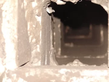

My house was built in 1925, sometimes later the chimney was lined with the yellowish clay liners. I want to hook the wood burner into the chimney but dont know what to think of it? I looked inside and they dont appear to be cracked or damaged, no soot or creasote build up anywhere. here is a few picture of what I can observe from the basement looking up... I believe these are 8" inside diameter square liners the flue opening for the stovepipe is about 1 liner above the bottom liner.

Probably going to want to send a liner down that. Veterans here will chime in with everything you need to know.
yeah for clay liners to be useable they need to be continuous top to bottom yours are obviously not it needs lined and it looks like it will be lots of fun to try to fit a liner in there i see lots of protrusions to interfere.
That flue as it stands is an invitation for a nightmare. Best you can do is bust out the clay liners then install insulated, if possible, or stainless liner with poured insulation around it like vermeculite. Liner needs to rated at 2100 deg.

Yes, I watched a youtube vid where they bust them out and run a new liner, I dont even think a 6" liner will fit in there? Id like to have the 8" liner installed as I want to install a wood burning furnace next year if possible.

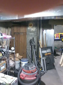

Yes, I would have it professionally installed anyways. With my basement it is possible to run out the wall and up the side of the house as well with a flue. Depending on which is easier. Since the chimney is open in the house it would be easy to tear it out and build a surround for the new pipes...

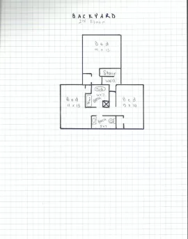

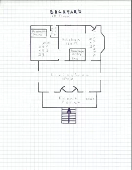

My house is 1400sqft. an odd setup as it was built in 1925 by a farmer in 4 stages.

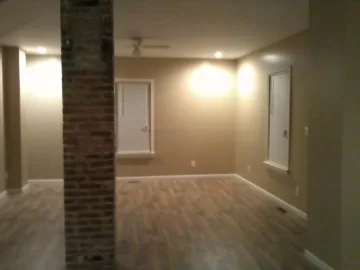

If it isn't too difficult to go out the basement wall, I'd be tempted to tear out the chimney just to get it out of the center of the living room and forget about an interior chase. It'd open up the floor plan even more.

Yes I agree, it is off center until it gets into the attic then shifts over a few feet to go out the center of the peak of the roof... really odd design. If they would have put the doorway in another location in the basement then it would have went straight down,
