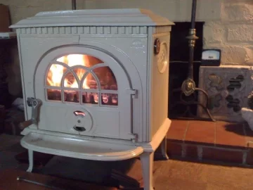

Been fooling around with an older Jotul Model 8 that sort of arrived along with the new house we moved to. This is an early '80s model, made after glass windows became popular, but before catalysts, secondary air, or airwash were developed. It's built from nicely-made individual cast plates, and has the spin-type draft control on the front door like this:
I've been adding ceramic-wool insulation between the firebox liner plates and the outside of the stove, and also on top of the baffle... along with a few firebricks around the upper part of the firebox, in order to encourage this stove to burn hot and clean.
My shoulder-season fires did a good job heating the room and didn't smoke too badly, but the glass in the door did get pretty smudged with smoke. This morning we had temps hear freezing so I had a good excuse to load three oak splits and let 'er rip. I had flue-collar exhaust temperatures around 1000F for an hour or so, and got the stove body (upper right side corner) up to about 650F. The neat thing was that the door glass, which started off dark brown, burned itself to near-crystal clear after the first 20 minutes or so... the cleanest it's been since we got the stove. My IR thermometer reported the glass outside temp at 750F, so I'm guessing the inside face was 50 or 100 degrees hotter than that... self-cleaning-oven temperature it seems, cause that's what was happening.
Anyway I miss the glass airwash on my old Avalon, but its nice to know I won't be spending the whole winter trying to see my fire through smoky glass, even with the early-modern-era design of this stove.
Eddy
