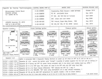

making sure you have a clean stove is a good way to insure fast ignition, but also how many pellets that are fed into the pot on start up matters as well. the feed rate will only change the maximum allowed feed rate once the stove is out of start up phase, the initial feed amount is time based and can be changed by changing some dip switch settings on the control board. I personally found that when the pellets where just touching or kissing the first row of air holes in the burn pot (the row of air holes closest to the auger) I would get very good, low smoke lights. the more pellets past that the longer it would take and the more smoke that was produced.
How do you change the dip switch or does it have to be done by a service tech? It seems like when it first starts it almost all the way to the edge of the burn pot before it starts to ignite.
you can change the dip switch settings yourself, it isn't overly difficult but should be done carefully (stove unplugged and gentle with handling of the control board) as far as how to do it, normally you have to remove the control board to get to the dip switches, the first 3 turned in different combinations of on/off will change the amount fed on startup, you will have to find out from some one else what the combination give you what as I am no longer a service tech and don't have that information anymore.
on start up with a totally clean and empty burn pot if you turn the stove on to light it the auger should run and run until it stops, if the point where it stops the pot is completely full of pellets then you should change the dip switch settings to reduce the amount fed in. the stove will try to feed in more pellets after the initial feed in amount if it doesn't sense the fire has started after so many minutes of trying, but this should never occur to a properly running/cleaned/set up stove, it should light well before the control board tries shoving in more pellets, so if the stove does feed in the correct amount on start up and then later shoves in more till over filling the pot then you should look some where else than the dip switch settings...

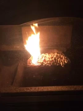

I'd like to re-open this one. My P43 has been running for 6 years (3 in the A-frame & 3 in the garage) & I've done all the maintenance on it. It's eaten a couple of ESPs ( 3-blink) & I changed them using factory Harman replacement parts. Got up this AM (my daughter was away for Turkey Day) & had a 6-blink & an empty hopper. Shut it off, filled the hopper & fired her up. Room temp auto - 68 degrees - feed rate 3.5... Seemed to take a lot longer to fire & when she did, it's primarily a left side burn
(See attached pic).
The fines box cover is on correctly & the wing nut is hand tight.
I'm thinking that the gasket inside the fines box cover has failed...
It looks like it's compressed on one side & it may be letting air in...
Thoughts?

I'm no professional but there are way to many pellets feeding so it doesn't have enough time to properly ignite them. Try messing with the dip switches and take out the igniter and clean it.
(See attached pic).
Thoughts?
Did you clean the ignigter chamber and start with a fairly clean firebox? I've noticed that if I don't do that for a few restarts I tend to get a slower start and burn. Never shoved pellets over the edge though.
