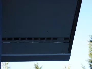

Now I've got a nest in a second story soffit. It's in the gable rake on the corner with no access to it from the attic or the ground. There is a 22.5" x 22.5" x3.5" square that is completely boxed in other than the aluminum soffit vent where they found a way in. Any ideas on how to get rid of them, I was thinking of duct-taping it up at night, or hanging the bug zapper up there................. Any ideas? I really have no place to soak them with Raid effectively, I'll take a pic if that helps.

Take a picture so we can get an idea what you are facing. I am thinking you might be able to dust it with Sevin.....long piece of 1/2" pipe, pour some Sevin in then blow it with the air compressor if you have one.

A friend recently dealt with this same situation. He sealed up the access openings (at night of course) except one, which he covered with the cap from an insect fumigation bomb which had a hole thru the top (allowing the wasps to pass normally). The next night he set-off the bomb, then inserted it into its cap. Problem solved.

This is from outside the bedroom window, it's about 18' from the ground.

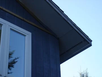

The second pic is from the ground, you can see that I have not put the aluminum trim coil opver the rake yet, this is why they can get in at the end of the soffit vent. This is about the last thing I need to do outside, but when I was going to I saw the stream of paper wasps in and out the gap.....Was not excited to be on a ladder with those things buzzing around nad me driving nails.

Can you get out the window with a piece of plastic pipe or set a ladder out a good distance then pour some Sevin dust in the pipe hold your thumb over the end or a piece of masking tape. Reach the pipe over to the openings and blow the Sevin in with an air hose. Sevin will not kill them instantly like spray but they carry it in on their body to the nest.
Taylor being close to winter you might just wait a few more weeks and get after them when they are dormant.
I've had a nest of red wasps in my garage soffit or over my shop ceiling and plan on neutralizing them sometime after I stop seeing the daily activity this winter
