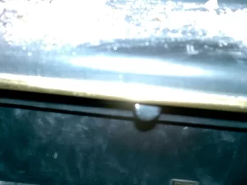

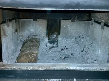

First I start with a log.
  • [Hearth.com] Yet another stove-lighting thread...
...Then another one along the other side.

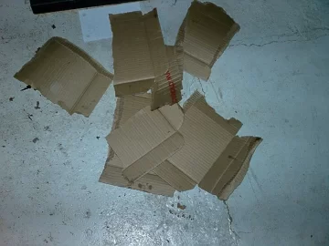

Then tear up some cardboard.

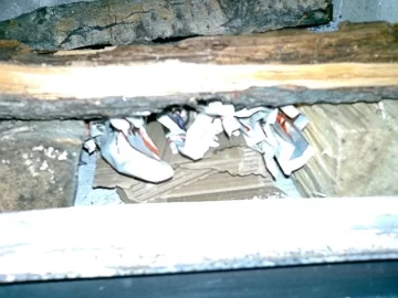

Put the cardboard in place, topped up with some newspaper. Then add a couple of peices across the two original logs, forming a bridge...

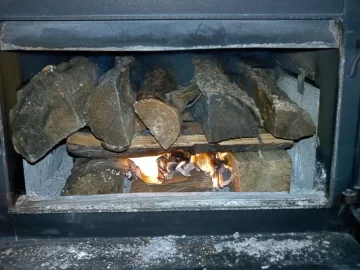

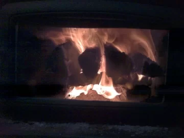

Add more pieces front to back, notice they are not exactly kindling. Looks like Tamarack and Poplar right now, and maybe a piece of ash. There is a total of 9 pieces in there.
Light 'er up!

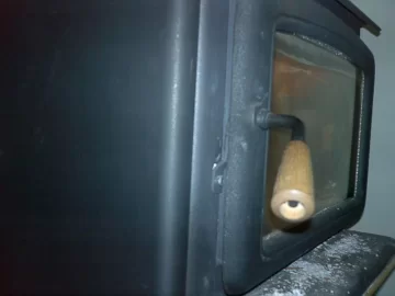

After about 2 minutes, close door this far...

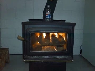

Door is still open after 7 minutes from time stove was first lit. Note the plastic bottle on stove, showing top is still fairly cool.

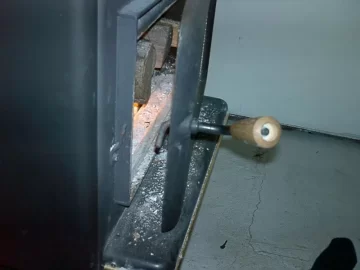

A couple more minutes have passed, time to latch the door, 9 minutes after being lit.
