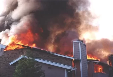

The worst way to find out you have just a little bit too much build up in your chimney / pipe. How is yours ? Do you know ? Do you "THINK" its clean ?

Pretty sobering pics
Makes you want to pull the cleanout plug and take a look when you get home doesnt it?
We need a thread like this every month to keep us all on our toes ;)

Thats why i posted it ....... Also there are a lot of people buying there wood and its still "green" when they try to burn it . This just happened to my brother . Bought wood for the year 2 months ago and its not set up yet .........He was getting a lot of build up in the stove and pipe. Told him to clean it out ASAP , the very next day he had a chimney fire with his NEW STOVE . Its been warm up tell now this year so with small fires going and now the cold has set in the stove gets more heat going and can light off a crusty chimney/stove pipe.

my chimney fire and my chimney looked just like picture #13 the only difference was my flames were going straight up and there was no smoke involved
Holy Cow..........very scary stuff. Have never seen pictures of a chimney fire before. Truly made my hair stand on end. Important visual for prioritizing proper maintenance of the stove.
Thanks for the reality check.
