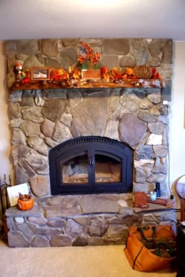

  23. Got Wood
    Got Wood
    Oct 22, 2008
    927
    120
    Dutchess Cty, NY

  24. madison
    madison
    Sep 12, 2008
    1,532
    112
    41.33°N 74.18°W and 44.67°N 111.0°W
    Very cool looking hearth and fireplace. Was the existing hearth a similar stone, and the new one rebuilt with the old stone around the FPX?
  25. Got Wood
    Got Wood
    Oct 22, 2008
    927
    120
    Dutchess Cty, NY
    Thanks. We love the look.
    No, I ripped out everything and started from scratch. I didnt really like the prior hearth (red brick). I actually scrounged all the stone and did the hearth under the guidance of an experienced friend.
