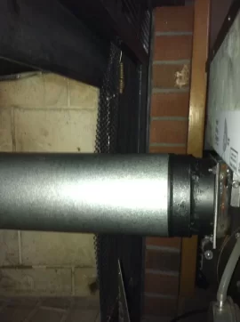

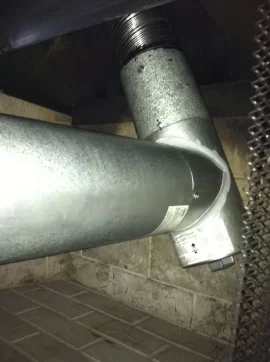

I have a Lopi Leyden sitting in front of my prefab on a hearth pad extension. 4" Venting out the back into the firebox is: Stove Adapter --> 12" Horizontal --> T w/ Cleanout -->Flex Liner Adapter --> ~25 feet Forever Flex Liner to the top and capped off.
Get natural draft and can get behind the stove for maintenance and to clean out the T. Original Fireplace not touched and still functional in case ever sell the house. I found this better than an insert.
