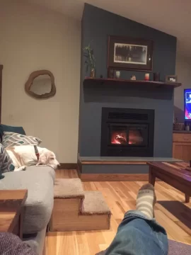

We built a new house and put in a zero clearance fireplace but it’s my 3rd EPA stove. I chose a Kozy Heat Z42 CD, the double door model.
Heating around 3000 sq ft with it almost exclusively in ice cold northwest WI. We do burn a little propane to heat the garage floor and I have the basement floor set to 60 just so it’ll fire and stay warm a few times a week on cold nights. It isn’t necessary but a comfort thing. The fireplace is on the main floor in the 30x30 living room/entry/kitchen with 12 foot vaulted ceilings.
I cut my wood at 16” and it works best to load north to south. Had a couple weeks with temps never getting above -5 and I burned about a face cord during those times. I typically load it in the morning at 5, go to work and come home 10 hours later and will load it again. I then wait for the bed of coals to get just right then load it packed full as I can for the night. If it’s a windy or especially cold night I might wake up and load it once in the middle of the night but will have coals in the morning if I don’t. The main floor temps are between 70-80 and the basement 64-68, no propane. I have a programmable thermostat that runs the furnace fan periodically. Very cozy and sometimes windows are open.
House is ICF foundation with spray foamed rim joist and R21 fiberglass walls. R58 attic.
I’m happy with the unit and its performance. I hardly use the blowers at anything over low and the heat output is very impressive. I think the BTU rating is too conservative.. Wood use is low and my only two complaints are the door gasket adhesive at the overlap failed right away and the air wash is pretty weak. I have to run it like a foundry to keep the glass really clean with dry wood so I just clean it once a week when it’s cool enough. I just like to see the fire. I cleaned the chimney after 1 winter of steady burning and got about a half cup of gray ash. Smoke is only visible on reloads.
It’s one of the lower cost ZC units I had available but I love it and expect it to be in heavy use for many years. It’s made near me and there are a lot out there without many complaints that I could find.
