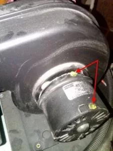

If you have the Fasco like most stoves, the oil holes for the convection blower look like one of these....they may have plugs covering the holes, or not. 2-3 drops of light 20w non-detergent or 3 in 1 in the blue can will be just fine:
  • 5-10-2011 stove offically shut down.
