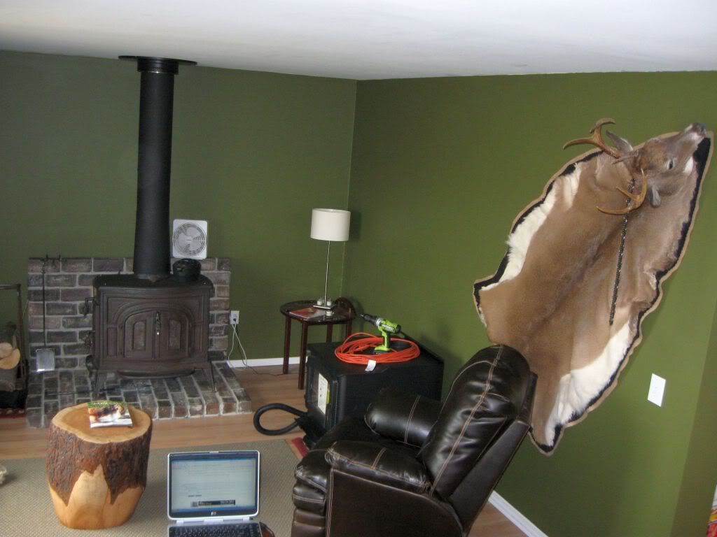

I am adding some more to my hearth and getting ready to install the NC-30. I am going from 6" on the stove into 8" - not ideal but the set up is 1 yr old and a 16" straight shot so I am confident it will draw fine. I am looking for an adapter. My stove pipe and chimney are all Duravent and the stove pipe is double wall. I am hoping to just get a 20" or so piece to go from stove to pipe but wondering if I need to go 6" to the start of the chimney at the ceiling?
Any suggestions on choice and more inportantly where to buy??
current set up:
current set up:
