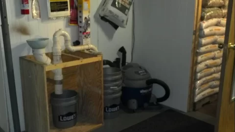

I have been burning Turman pellets with my Englander 25-PDVC and I have noticed that the TURMAN has a lot of fines in every bag. I was wondering if anybody has ways to filter them out?
Less than $20 in PVC material (Not counting Shop-vac).
To each there own. I only Sift the bags for my Quad....
The other 2 just eat them.

Because its a Spring style auger, the fines sit at the bottom of the hopper. A hollow spring will not carry sawdust (fines). A solid Screw and Cylinder style auger carries fines pretty good. Some better than others.
So it slowly builds up and restricts the feed of pellets. Decreasing the amount sent up the auger.
Some of my pellets have very little fines, some have a lot... But sifting shows you that its not just fines at the end of the bags.... Go very slow, and you will see they come out the entire pour. Lighter until the mid point, but after that, most would be surprised by the actual amount in each bag (Jay shows in his testing).

i keep it simple and have never felt the ill effects of fines. when i pour a sack into hopper i stop with about an inch or 2 left in the bag. i dip into the bag with a pool skimmer basket, (i used to use a "scolapasta") give it a few shakes in the bag & dump the basket into hopper.

Here is something I made/posted that I still use for every bag of pellets and has worked well for me.

Hamers pellets have a lot of fines this year, and I don't see the point in dumping all that extra sawdust into my stove. My feeling is that it will eventually work it's way into my auger motor bushing and cause trouble, why accelerate the process by dumping useless sawdust into my hopper? It only takes a minute or two per bag and also cuts down on the dust that would normally fly out when pouring bags into the hopper.

i made the sifter like Dexter shows.Works great.I showed to my son in law and he wants to make one.It really picks the dust out.Besides it's easier pouring the pellets in from a bucket than the bag.If you ever let the bag touch the hot spots on a stove you'll see what i mean.

OK, I've seen this before but can't figure out how it works. Can you explain? Never mind... I figured it out.
