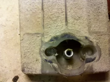

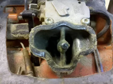

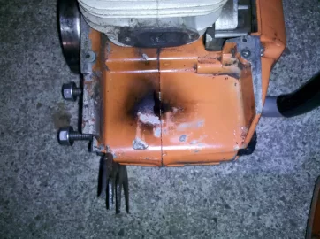

    Well I fixed the screw on the cover that was letting saw dust in, put a gasket on the carb throat ,gave it a shot of carb cleaner and it's running fine now but in last pic I found oil seeping out, is it coming from the bar oil tank ;? First two pics are of all the crap that got in the carb

    Looks like maybe a leakin case gasket? That's not a simple fix. Would involve splitting the crankcase. I'd leave it alone unless it's making a real big mess or the gasket starts to leak air into the crankcase.

    I only ran it a couple of min.though

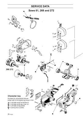

    So , unless the other part of the gasket around the crank case is leaking,It's ok to run ??
    I will check torque on bolts, screws

    I would try some JB Weld on the case leak foist... splitting them is a PITA. I have done some amazing things with chainsaws using Super glue and JB Weld.

    I was thinking maybe JB Weld, if I can get it clean enough to stick, might work out

    Use something like Xylene to clean it with, or even lacquer thinner to get the paint off. I have used JB on plastic parts, magnesium and aluminum with very good results. That stuff holds up well over time.
