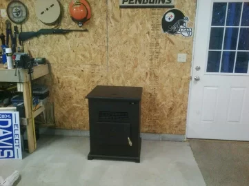

Breckwell Big E, opinions?
Looking at a used 2006 that has been stored since 2008. The price is right, I just don't have any experience with this brand. Had Whitefileds in the past.
I am installing my new one this week if I can find time. I will let you know how it goes.
  • Breckwell Big E, opinions?
