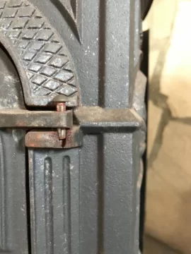

A couple of years ago my wife and I bought our first home. Right away I was excited about the wood stove what Im pretty sure is a Vermont Castings Intrepid 1302 (no cat). Since then I have been getting better and better at using this thing, but today, the door hinge cracked a piece off. The door came loose, however I was able to push the pin back in enough to hold it together as I had already started a fire. The hinge broke long before the stove was hot so I suspect it had been weeken somehow.
Im at a loss on how to fix this thing. From my searches, it sounds like adhesives are not the best thing. I do not weld, however I do have some friends who weld. Looks to me like the front is attached to the entire unit, im guessing replacing the front by itself isnt possbile.
Ive attached a picture with the damage and would appreciate input.

Looks like all cast iron. Not easy for a welder. VCs don't get a lot of love around here, the modern VC stoves are awful but yours might be old enough to be from the good old days.
Consider the cost of a new stove compared to the cost of repairs with this one. Is it worth fixing?
Well, at least it's a top loader. That is going to be tough to repair permanently without replacing the front of the stove. One option might be to put a steel retaining strap across the pin area. This would take drilling and tapping for small screws on both sides to hold down the strap.
Reactions: Woody Stover
I am just a self-taught farm welder, but with my old arc welder I have used the special rods for "cast iron" to successfully repair various cast parts. I think someone could weld the piece back on. Might not look great, but after some artful grinding maybe okay for you.
