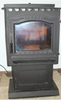

    If the newer Harman P38s have the older Harman P61 control board, then is it possible to change it to the P61A control board and change the burn pot and ad the ignitor?

    it has always been possible to upgrade the P38, they used to make a whole kit to do it. I'm not sure they make the kit anymore, but I converted a P38 to a P43 last year, no worries.

    I think I still have a couple of those kits, but originally they were made to convert p61's to p61-a's......and it was was never really easy to do (the burnpot wasnt drilled and tapped for it, etc). I would think it would be easier these days to convert a new p38 to autoignite, but you would need a new circuitboard, which would fit on the standoffs......as for converting an "old" p38, would be more complicated, but do-able, just dont think it would be worth the expense to make it autoignite.....have to add the parts up, but you'd need and igniter, wiring harness, circuitboard (and likely more)......thats around $400 for the parts alone, let alone labor......unless you do it yourself.....interesting project.....

    the old p38 burnpot wouldn't allow for the igniter either...slot too narrow, had to use an Accentra FS burnpot to make it "easy". I agree, not worth the expense, but a fun project anywho.

    control board, igniter, ESP, burnpot and flame guide and you take a P38 and trun it into a P43

    Sounds good but still a tad expensive.
    http://www.stove-parts-unlimited.com/Harman_Circuit_Board_Control_Panel_Most_Models_p/1-00-05886.htm
    $210.00 - Control Board
    http://www.stove-parts-unlimited.com/Harman_Pellet_Stove_Flame_Guide_p/3-00-08534.htm
    $33.00 - Flame Guide
    http://www.stove-parts-unlimited.com/Harman_Thermister_Probe_ESP_Probe_Red_Wires_p/3-20-00844.htm
    $56.00 - ESP Probe
    http://www.stove-parts-unlimited.com/Harman_Accentra_FS_Burn_Pot_Weldment_p/1-10-08736.htm
    $150.00 - Burn Pot
    http://www.stove-parts-unlimited.com/Harman_Igniter_Cradle_Kit_1_Set_p/1-00-06620.htm
    $25.00 - Ignitor Cradle Kit
    http://www.woodmanspartsplus.com/734676/products/Harman-Stove-Igniter.html
    $86.00 - Igniter
    http://www.stove-parts-unlimited.com/Harman_P43_P61A_and_P68_Circuit_Board_Plate_p/1-10-08327.htm
    $35.00 - Knob Panel
    http://www.woodmanspartsplus.com/939/747536/Unassigned/Harman-Stove-Wiring-Harness.html
    $43.33 - Harman Stove wire harness
    $638.33 -- Is that everything?
    MSRP is $410 more for the P-43 so not so bad for the upgrade parts!

    pretty hard to argue with those numbers! youre missing the burnpot gasket tho, and shouldnt need a new ESP probe......just a dipswitch setting on the new board needs changed (switch 5, I beleive)

    It is #5 that would need to be changed depending on the ESP used. Willing to bet if you ordered that much stuff some sort of discount could be arranged too.
