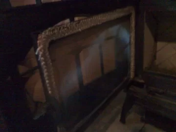

Can you replace the original gasket with a 5/8" door kit from Lowes?
The owners manual says the door gasket is 3/4"....don't substitute smaller....you'll get leaks. Any local stove shop should have the right size:
from the owners manual - "Gasket (Rope), Door, 3/4 inch, 7 ft"
EDIT: try HD...they have it sometimes.
OK, here's the deal, and I am NOT suggesting you do this unless you're as messed up as I am. The oem tadpole gasket runs around $40 or so, that made me upset when I saw regular gasket kits at the big box for less than $10. Problem is, the door has an airwash gap either top or bottom, and the tadpole also fits under the the glass on the front side. So, your dealing with very precise gaps, mostly the airwash one. If you replace the oem with a regular 3/4" (yes, has to be 3/4") gasket, you'll mess up the airwash gap and your stove will not function well so keep that in mind, i.e. the gap will be too big or small when the door is closed. All that said, it can be done. It took me alot of tinkering and a new airwash baffle from jpt here, but it works like a charm now. If you 'go in', do NOT bend the baffle at all, any bend will cause ash streaks, that's why I had to replace mine. You need to cheat the two screws on the baffle, take the baffle off and shim it so that the gap between the baffle and the glass is correct (1/8" or so?), I used a couple trim nails laid on their sides between the baffle and stove for shims. Did you know that high temp rtv works great for combustion blower gasket too? Don't wreck you stove based on what I have done to mine, but man I have her dialed in and working great! REALY crappy pict below, it's dark in the basement and the cell phone has no flash!

I went to lowes and hd both said 5/8 was the gasket kit to use. they do not carry 3/4. Think i'll buy the oem part. Do you know if the oem part comes with the gasket glued to a new piece of glass? Also do i have to worry about the air gaps with oem part?

Don't listen to anyone at Lowes or HD....they don't even SELL Quadra's....how would they know what was right??? (idiots)
Yes, buy the OEM gasket if your the least bit unsure, and ask the dealer about replacing the gasket. Maybe they'll have a Castille on display, and you can see what it looks like from the factory....ask questions about the glass and the air gaps!!
How old is your castille? I replaced mine after 2 years. I took the door off and brought it to the stove shop I bought it at, they carry replacements for the castille and i asked them if they could show me how to replace it, i bought the gasket (pricey)forget how much though. They put it on- was a self adhesive type. Now on my 3rd year and was thinking part of the gasket is pretty frayed again but did the dollar test and will put up with the frayed part for now.

That's not the right gasket. This is the Tadpole gasket.
http://woodheatstoves.com/gasket-tadpole-door-p-2096.html
RECEIVED MY OEM TADPOLE GASKET TODAY. HAD INSTALLED IN 30 MIN.LOOKS LIKE ENOUGH GASKET FOR 3 STOVES. NOT BAD FOR $45.READY TO FIRE HER UP!
