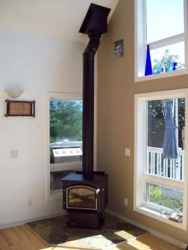

Well, we are hesitating now because we are worried about how the stove pipe will look in the corner of the living room going up 18 feet on the inside! We have cathedral ceilings, which means good heat transfer to the upstairs, but black pipe going all the way up to the ceiling. Can anyone on the Forum show me photos(s) of this type of install? I think it would make us feel better to know that someone has done this before, that it looks good and won't hurt the resale value of the home. Thanks again!
-Heather
I think it will look great, and you will get terrific heat transfer with all of that pipe inside. Here is a link to my install, which I posted on the Perfect Picture forum. The middle picture will give you the best idea. You are looking at close to 10" of pipe. You have considerably more at 18", but I still think it will look great. One thing I definitely suggest is to build up the hearth as I did. Aside from other benefits, it looks a lot better built up when you have high ceilings and all that pipe. Or else the stove will just look puny. https://www.hearth.com/econtent/index.php/forums/viewthread/14900/ Let me know what you think. Also, if you go to Hearth.com Home and click on the picture gallery, you will probably see some more pictures. Good Luck!
I have seen colored ceramic pipe that looks GREAT...don't know what your buget is Iam sure it isn't cheep but looks aussum!! but I have seen black pipe go 16 ft and it looked very nice. it really does blend in well
Here's mine. Probably not as high as your ceiling, but I think it looks good. We had to do the little angle jog at the top due to the location of the roof trusses. What do you think?

Mayhem, I love the location of that stove. That ceiling fan is in the perfect spot too. It must heat the entire upstairs beautifully. Does the heat move throught that hallway and also into the kitchen well?

Thanks, rubyjliamf...I used your thread as an excuse to order myself a really nice new wide angle zoom lens for my camera. (I know, pretty lame, eh?). Our Lopi Liberty in the house has exposed single-wall all the way up to a cathedral ceiling support box...about a 14' run from the stove collar. Can't really get a good pic of the whole deal with any of the lenses I have. You'll get the first one I take with the new lens. Thanks again. (BTW, we like how our stove looks in the house). Rick
