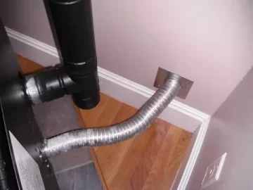

    I love having mine inside. I think it's easier. I just cleaned mine and had maybe a half a teaspoon full of ash. Here is a pic of what it looks like. FYI-This pic is decieving, pipe is 5 inches from the wall.

    Nice looking install!! Congrats. :)

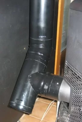

    I think it's just a matter of what's the more logical place to put it. I agree that having it outdoors is cleaner, but an indoor cleanout is more convenient, especially in the winter.
    here's my install...I had no choice on the T location:

    Pretty setup macman.

    Yes, nice job indeed. Congrats.
