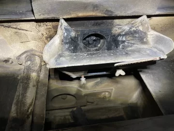

Cleaning out my p38 today, I have noticed more of this the last couple of years. Usually take some creosote spray then burn it off with a propane torch.

Running it nice and hot for a period every day ought to help. The warm winter this year causing you to run it cooler much of the time may well be influencing the situation.
what SciGuy said, with our P61, I’ll run it hot for an hour or so when it’s warmer out just to keep it nice and heat clean

Also go outside and look inside your pipe to see if you are getting creosote build.

No creosote in pipe, just around burn pot. Thanks to all for your replies.

I also had a large creosote build up. To remove the creosote I gently heated it and then used a wire brush. You may not get it all the first time.
From my reading I found that creosote can be an issue with pellets, or air flow. Since I was using the same pellets in both stoves and the upstairs stove was burning fine I figured it was not the pellets.
I cleaned all the ash out. replaced both rope gaskets with graphite embedded gasket material . I then cleaned the burn pot and blew the dust and dirt out of the igniter cage, and used a wire brush to clean he combustion fan and duct . I then used compressed air to blow out anything that was still there, I cleaned inside of the the outside chimney with a wire brush and replaced the top vent cover (I had used one that you could spin the top and it was gunked up).
After that I opened the back and did the yearly maintenances.
The stove started up and had a bright yellow flame and as of now have no creosote. ( I found if If the color of the flame changes or the flame becomes lazy there is probably a problem with the air flow)
