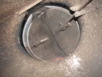

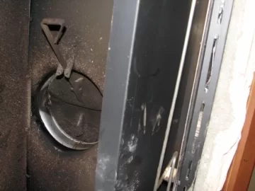

What is the best way to attach this to the sheet metal ceiling? It would be a sheet metal ring that would fit into the cylindrical recess for the existing damper. I am thinking that screws are not a good idea. Is furnace cement sufficient to hold the ring to the ceiling and to the liner?
