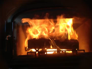

    $20 a month extra, that's nothing. I say only burn if your a burner.... The question is....
