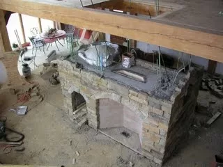

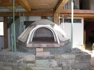

    Nice outdoor oven!
    I built one in my house using the kit from superior clay, and we absolutely love it. It's actually very practical and we fire it about twice a week. The refractory is not as thick as firebrick, so it heats up quickly (in 1.5 hrs), and it holds decent heat (you can still cook bread in it the next morning after an evening of cooking pizza's... without another fire.)
    This summer, we helped a friend build one in his backyard using firebricks - very similar to yours. Longer to heat up, but wow it will hold a lot of heat. That way we can use his oven for the three months of the year that it's not practical to fire our oven. (Even though ours puts out very little heat into the house, it's still no fun to heat the house up a few more degrees in June July or August!)

    Your backyard setup looks like a painting - surreal.
    Is that a pork over your fire pit? I'm getting hungry just looking at those pictures. Yes, a fireplace is a must. We started ours last week for the first time this season. Nothing like grilling in the winter. For steaks, we pull the coals near the entrance of the pizza oven, and then I have an old piece of stainless grate that we prop on firebricks over the coals. Or sometimes, we just throw the steaks in the pizza oven and sear them right on the firebricks. Its amazing that they don't stick. The best part is the cleanup... a hot fire will obliterate all traces of grease, food, soot, etc. and return the oven to a bone-white state.
    What is the size of your pizza oven? About 3 feet inside side-to-side? Ours is 36" but the height tapers to zero at the edges, so it's more like 30" effectively. I think 30 inches is about the minimum a person should go. Unlike ours, it looks like all of your oven is usable space. To build ours took about a 5.5 foot by 5.5 foot chunk of real estate out of our kitchen/great room. It was hard to give up that much space to something we thought might turn out to be a novelty. In retrospect, it was the best 30 square feet we ever allocated in the house.
