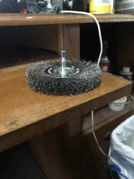

I can’t recall the name, but it was orange in colour. It took me way too long last time to remove the old stuff. Probably 2 hours with the screw driver to try and clean it all up. The way i applied the last batch, i’m sure it’s going to be even more difficult! Can you post a pic of the attachment you put in your drill?
This wire wheel helped to clean things up but it was no match for the bulk of the old cement...I had to first scrape most of it out in order for the wheel to be effective in cleaning things up...

I concur the old school gasket cement is hard to get off. Wire wheel on the drill, hammer and screwdriver The copper high temp RTV can be found in an auto parts store. I assume now the stove stores have RTV.
