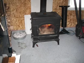

Mine is a dutchwest medium non cat. I bought it in the fall of 2006 when my new 1500 sq ft shop was built. Doesnt matter, but I have gel filled electric back up in case I have to go away, but back to the stove. The chimney is staright up 16 ft. (two story building). I was imeadiatly impressed by the heat out put versus wood usage. I burnt 2 full cord last year and probably a face cord over that this year. we have had a tuff winter here in Michigan. I want to add that the reason I bought this stove is the fact my brother has and older cat model that has worked good for him. My son has one just like mine. His has worked great also. he bought his on advice from my brother, and so did I . I had been heating the house with a wood furnace, or i should say wood eatin monster. Nuff about that peice of chit. Ive gone to a jotul in my house mainly because Im tired of putting 8 full cord a year thru the furnace. I dont really see a difference between the DW and the yotul in terms of ease of use, and heat out put versus wood consumed. The only work Ive had to do on the DW is to remove the top twice and clean out the air chambers on the side. I can build a fire, get her going and at some point depending on wood and other factors shut the bypass and hear a big woosh, When it does that I assume the ever burn system is running. It will run for 8 hrs and keep it 72 on average maybe 6 hrs when its 10 or lower out side. The head wood guy Chris I think is his name said that they take a little getting used to as far as the operation of the stove. I found mine very easy and user friendly. Maybe they work good in some applications and chity in others, dont know. Maybe Im lucky
just took this photo a few minutes ago

Yeah...the whoosh. I would hear thattoo, but it was short lived. Have you actually looked at your chimney outside after this thing's had the damper closed for say 30 minutes or an hour? I'm curious to see if you have, and if you have seen lots of smoke coming out. Mine would heat just fine, but it smoke like crazy, which it's not supposed to do.
Hanko - interesting - your chimney represents almost the perfect one - as per EPA - about 15 feet tall or so straight up insulated (or at least in a heated area).
So I do think we are/were on the right track in terms of the chimney/wood/operator having something to do with results. This stove just has a narrower window of the "slop" in the system that it will accept. Over the years I have sold stoves, I have found other stoves that are this way...especially in the early days of clean burning. I remember a Canadian model that would pretty much shut down when you closed the loading door (that's how strong of a chimney it needed), but if and when we got it going it would definitely burn the gases.

Its not a smoker, and when i cleaned my chimney last spring (07) I found no measurable creasote. when its idleing I run 350 stove top and about the same on the stove pipe, single wall. same for Jr and bro. we are burnning good dry wood. I should also note i have an outside combustion air sourse. My shop is spray foam dense pack insulation and its very tight. found that out the first fire last year. pulled a negitive in the shop and filled the place up with smoke
