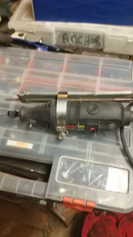

I also use the dremel. I hose clamp a manual chain file guide to the dremel. Did it years ago. I use the angle from the manual file guide, while using the dremel.

I have that, too. Having a tough time imagining how to clamp the dremel to the manual file guide. Any chance you have a picture with the dremel attached?
One hose clamp
