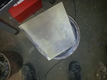

Just if you get a chance and willing, it would be nice to see a picture of that baffle
as I went to the store and it was a 2010 model that was on display..
Cheers
Pic of baffle ECO 65 Baffle..
Yes sure it is in the stove, I don;t see why SBI does not sell you one. It has 2 brackets that hold it in, they could sell you the brackets too... When I get a chance on next cleaning I will send a pic..

My thought....it looks to act as a buffer between the flame and the underside of the upper heat exchange tube. There is a space of an inch or two between the baffle and the exchange. I looked at my stove with the heat setting on 2 and the flame was touching the baffle. Maybe it 1) creates more heated surface area and/or 2) protects the upper exchanger (?).
I do not know if it impacts the window cleanliness.
I don;t know about the glass, either but I can only assume it changes the direction of the draft, as the gases must go straight up and then around the baffle then into the heat exhanger, maybe it makes it more efficient? The longer you can keep the gases in the more heat they will transfer I am assuming.

I will send you pics and any dimensions you want of the mounting hardware and baffle. You need to ask them the benefit of having it , compared to not having it...My glass says clean for about 2 days, but that is not because of the baffle......
