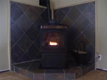

Want to replace my englander with a harman but the vent pipe location side to side is different as well as the height of the vent pipe. The englander is 13" from floor, the harman 9". Anybody make this switch and how did you remedy the vent pipe location?
