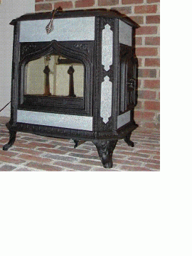

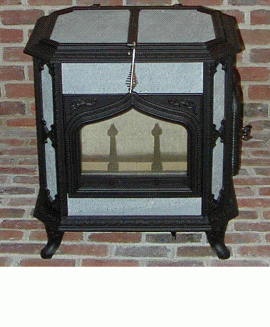

    Heres a few pix as she sits on the hearth. It gets the pipe run tommorow:
  19. MAJ. Woody New Member
    joined: Jan 28, 2006
    23 posts
    Virginia Beach, VA
    I'll try again....Sorry that they are so pixilated, I couldnt reduce them enough to save in a better quality.

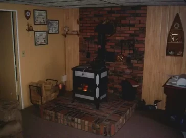

    Here you go.

    Great looking stove and setup.

    Wow! Thank you both so much for posting.
    They are awesome! I can't believe how big, the fireview is like twice the size I thought. I can see the cast iron has decorative impressions, I love it! Boy, you both are going to simply love them. Todd, by the size of it you won't be worrying too much about being too cold on the coldest days now :) They look great! I recommend a little extra wood for next year, or don't be upset if you're going through more wood than normal in the beginning. This was the first season using my new unit and now that winter is almost over I've finally got the hang of it and getting more miles out of my wood. So, expect to burn a little more wood than normal until you get the hang of your Fireviews. Seeing those pictures brings back how much I love andirons.

    That is a classy looking setup you have there!

    Oh and BTW, are those Shellback and Bluenose plaques hanging on the wall??

    Plank owner, Great Lakes Sailor, and Last cruise plaques. 20 years US Coast guard. What does the MAJ. stand for? Military or just a little horny?
