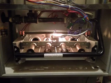

My furnace started working intermittently. Sometimes would fire after 10 tries. Called the furnace guy and he came by yesterday while I was at work, replaced a part, charged me $250 and said it was fixed. Last night I could hear the furnace come on and fire but started to short cycle. After 1/2 hour of that I had to look. Only two of the burners are firing on either side of the ignitor and the flame is orange and All over the place. Called furnace guy this AM but he lost my ticket and won't be by now. I've attached a pic. Any ideas????

Had a similar problem a few years ago. The fresh air intake for the furnace (outside the house) was pulling fine snow into the intake and causing it to plug enough for the furnace to short cycle. Check to make sure that pipe is clear.

I'd bet your gas meter has frozen up outside. Easy to fix..
1. Make sure it is physically free of snow and ice. If it doesn't seem like its buried or encased, then go to step 2.
2. Pour hot water (not boiling) over the meter and it will thaw. You'll need a gallon or two.. just normal hot water from your shower will do.
After its fixed
1. call your gas company and tell them to replace the meter.
2. Put post on this forum letting everyone know what a great guy I am for telling you how to fix it! (LOL)
frozen meter sounds good. what was the temp outside while this is happening. if not frozen is anybody on your street having the same problem? i've seen a whole street have a pressure problem so that only half the street could get gas at one time not the whole street. if not you may need a gas valve. have the hvac guy put a manometer on your valve to check your pressure.
