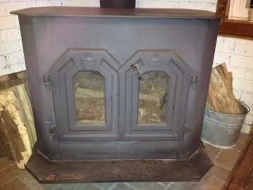

I have a Garrison One wood stove, which is in excellent shape. Just a little rust on the top. I'm planning on refinishing and was wondering when it was manufactured "1980", would it have been painted or polished. Mine appears to be unfinished cast iron. Anyway to confirm?

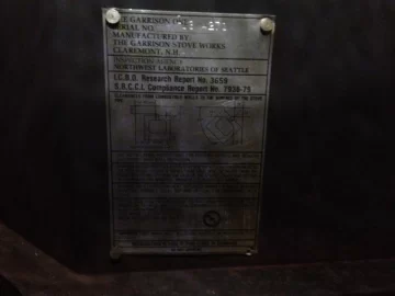

Coaly, I've got a picture and a manufacture's plate attached for your review.
Let me know what your think - Thanks,
  • Garrison One Wood Stove
Painted steel plate.
Heat lightens high heat stove paint over time. They can actually get white at the hot spots.
Wire wheel or sand any rusty spots and wipe with Mineral Spirits or Lacquer Thinner before painting. Fire stove for final cure.
