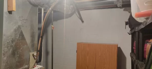

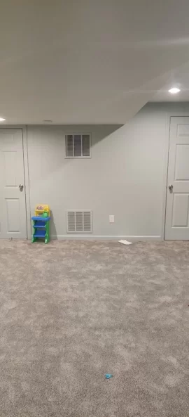

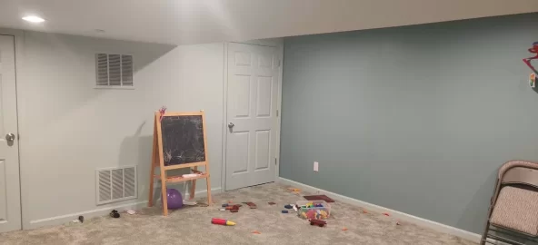

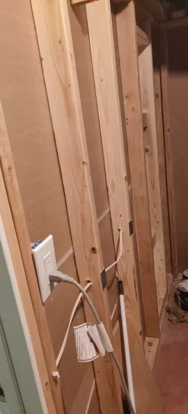

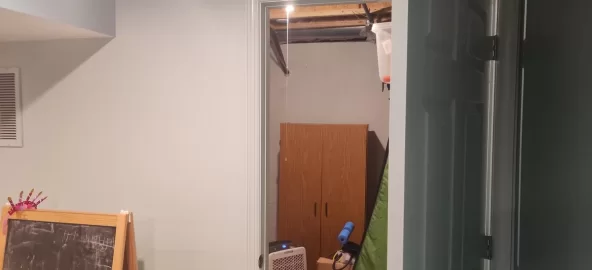

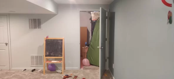

Any recommendations on good brands to consider for the stove? I have attached pics showing the wall in front of which the stove could go with unfinished space behind. If I turned around 90 degree, the adjoining wall is right under the deck but that would mean running plumbing through sheer rock and having to open up sheetrock. The reason I was thinking of putting on the wall shown is because of the access to the unfinished space behind.

Are you thinking of a free-standing unit - Stove,
or an in (or against) the wall unit - fireplace?
You will have to find a couple of units that will work for you & read the install manuals to
determine if you can run that far horizontally with the vent. There are ratios between rise
& run that need to be adhered to or the units will not perform correctly.
A gas fireplace could be installed IN the wall & venting that type of unit shouldn't be an issue,
not to mention the floor space that will be saved. Your call.

How much gas line needs to be run?
Thanks. I had a plumber do an estimate for the gas line. He will charge $340 if it's the wall with the door. If I have do the dark green wall the pipe probably needs to run outside and I will need to get an estimate for that. How are the other costs?
