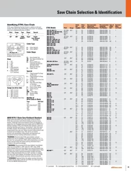

    The most common bar/chain sizes is .050 gauge & 3/8 (.375) pitch. The good thing about this size ,
    since it's so common, is you can get just about any type chain for your saw you want.
    But smaller saws have smaller pitch but may have .050 gauge. (small radius nose on the bar needs a little smaller pitch)
    Gauge is the thickness of the drive links & the width of the grove in the bar that the drive link runs in.
    On the chart you can see 1/4", .325", 3/8", .404" & some PICCO (low profile) pitch sizes & the Gauge sizes.
    Oregon & Stihl are the most common chain manufacturers . (Oregon makes chains & bars for Husqvarna)
    Most bars have the pitch & gauge on them.
    If you change the bar & chain , It is important to match the saw's drive sprocket (rim) to the chain & bar specs.
    Differences, usually smaller pitch & gauge are for smaller saws. Mid sizes for middle size saw & large for larger saws.

    Yep, what they said. To determine pitch, measure across 3 rivets & divide by 2.you'll come @ .325 or .375 usually.
    If you like, I recommend saving the chart that Dave posted for future reference. Very handy. Come back when they ask if you want chisel, semi chisel, safety, pro, skip tooth, full comp chain etc. & we'll confuse you even more.:confused:
