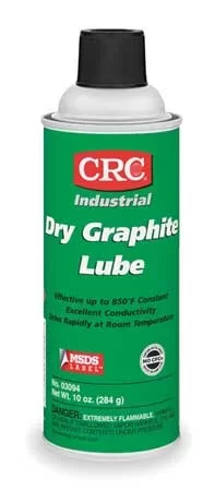

I grabbed a can of this last week and sprayed various part inside the stove after i brushed and vaccumed it. Its like night/day diff. I just shut it down and vaccumed it out again and its all still there and just the suction of the vac near it pulled the little bit of ash away.

Darn, just a can picture. I was expecting some pellet stove porn

I grabbed a can of this last week and sprayed various part inside the stove after i brushed and vaccumed it. Its like night/day diff. I just shut it down and vaccumed it out again and its all still there and just the suction of the vac near it pulled the little bit of ash away. View attachment 172503
This will probably be the next step to interior stove pimping. Do a very good cleaning and shoot it with this or similar.
Goes on just like paint. And only 5 bux a can id say its worth doing. Says it good for 850 degrees.

That would be good to use on the combustion fan blades. Probably just plain old good everywhere, stove pipe, firebox,hopper...old lady...er um..

Graphite, burn pots best friend!this what i bought but it says extremely flammable,,not sure if it's safe to use
Propellant in lot of cans is propane
