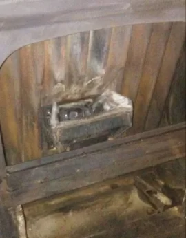

I have never had rust issues with my stove & i have had it since 2014 . i just like keeping the heat exchanger clean from ash build up the stove always burns hot that way. Scrapping only removes minimum ash but warm water gets it clean like new

Yup its amazing what just soap & water can do to clean ash ect. I dont use soap but i use water to clean the interior of my stove , then dry it with a hair dryer . works well with no rust yet
Here are some before & after photos of spraying the heat exchanger with warm water to clean all the ash off.
