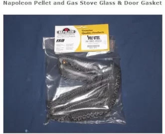

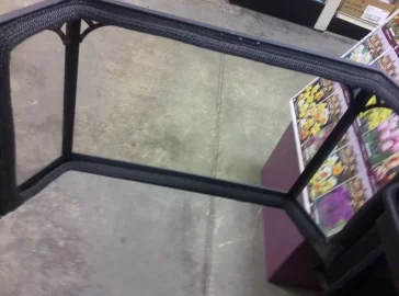

I am struggling to put together the door after replacing the gasket, there must be a secret to fitting the glass panels back in place with the new gasket. Any suggestions, my local dealer had no useful advice. The stove is an NPS40
The Napoleon pellet stove Door gaskets are very different! Not the standard rope gasket at all! You need to purchase the special Napoleon Wolf-Steel W562-0022 Glass & Door tadpole style gasket!
