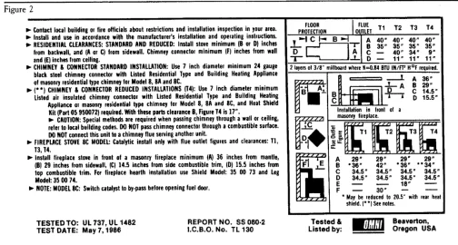

Do check to see if the stove has a UL label with clearances listed on it. Your insurance company and inspector may want this. If none, it is considered unlisted and the clearances for this stove are 36" in all directions. You may be able to rebut this by printing up the manual. Here are the clearances from there.
