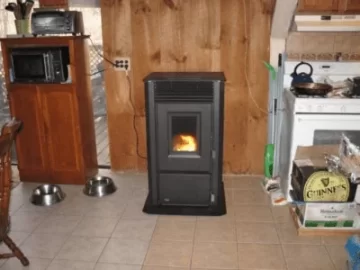

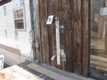

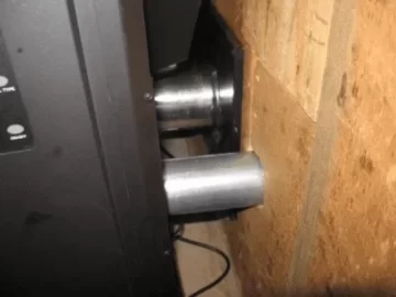

    Oliveone: Internet big, world small! Its the Maxx-M, multifuel. I'm still running on manual because I'm still not sure if my thermostat would work with this unit. I have a standard mechanical honeywell therm, about 3 years old, was running an old oil heater. Not sure of the voltage, but its as standard as they get. The book says to use a 12 or 24 volt thermostat, but the enviro guy said something about a millivolt something or other. (I did manage to squeeze out a few questions before he blew me off.) maxxx.png ventttt.png ventttt.png back.png
    Long story, but this dealer was only interested in the sale, they even tried to snake me into a floor model. They didn't mention a thing about the install, even assured me they could send me parts as fast as anyone. Cost me 3260 in total, brand new, delivered to my local lumber yard(included shipping was 260). But that was only the price because I told them I was disputing the sale because they were not honest about the stove being a floor model.
    Ekarlis: Thank you, I did read the section on the damper..... but mine came pre installed. Not sure if it was pre-set at the factory, or if they sold me a floor model anyway. The rod does not appear to be marked for the proper adjustment. Its tight though, I have to smack the knob just to get the rod to push in a bit. The diagram shows set collars but does not say if they or anything else are meant to be adjustments. Is the rod supposed to be this tight? I put an elbow on the end of my outside air intake, thank you. So far no problems today, running on low.
    Critiquing my install, I see I am missing a foot of pipe at the end of my run. I used 2 feet to run from the stove to the tee, but the kit diagram shows only one. No big deal to add another piece, but I'm not sure how or if it would effect the way the stove runs. I also see I need to foam my outside air opening, or get a 3" collar for it.
    Sorry about the double pic guys.

    Looks very nice! Get yourself a reasonable programmable stat. The Lux models are less than $30 and will do more all thats needed! I have the 500 and it has been doing a nice job with my stove for several years.

    Install looks good. Sent you a PM. Give me a call and we will c what we can do to get you running better.
