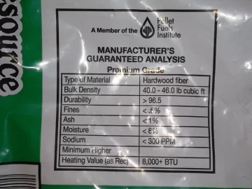

    I usually burn ~1 bag/day 40 lbs.
    However, when I had Woodfiber Inc's Hardwood pellets that claim 8000 BTU's cough cough
    I burned 3 bags a day while watching the temp in the house go down.

    You must have a very well insulated house to only need around 14,000 BTU for that square footage in the teens.

    And the lable on the bag of crap
