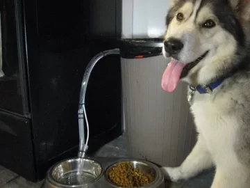

    Maybe you need to steal Fido's automatic water bowl filler rig, and install onto your stove pot. :p

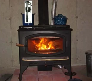

    Thanks Joful,
    But it looks like that one relies on gravity and I don't have a rain barrel on my roof...
