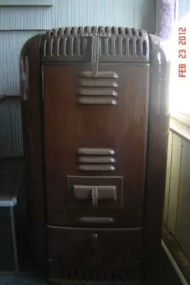

    What sized space are you heating? I can't speak anything about the old Eagle Foundry unit. Is it an old cabinet model like this?
    It will be pre-UL and will need good clearances. Performance unknown. The Resolute is a good stove for heating up to 1200 sq ft as long as it is truly in good working condition. $450 was its original selling price so it should be in excellent condition.

    Updated the above post with a picture. The Lopi X is probably the most serious heater if it will fit. But during a power outage you will not be able to use the blowers. That's is going to reduce its heating to the immediate area the insert is in.
